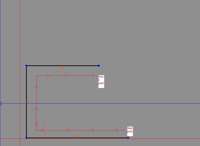

Paul Ford
Posts: 632
Joined: Wed, May 18 2005, 1:18AM
Location: Rotorua - NewZealand
Re: Problem placing cabinets in rooms
Post by Paul Ford »
Also make sure you draw your walls in a clockwise motion. When you draw your walls you should see an arrow pointing to the "Face" side of the wall, then when you go into the detail room area you should see a pink line around the inside of the wall where the cabinets are to be places.
Something like this...
