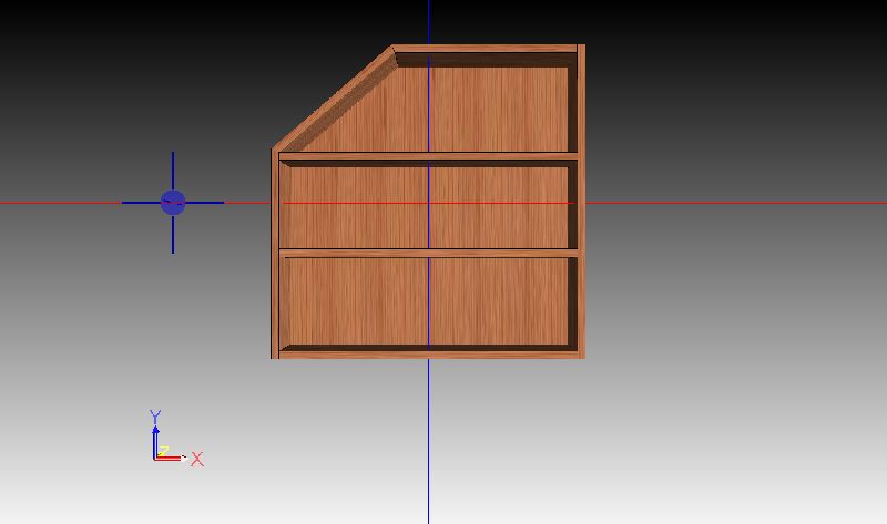

Brendon, are you talking about something like this?

Damon,
That is exactly what I am trying to do. It figured it could be done and probably had been done, but I have been unable to figure it out so far. Can you tell me how you do this?

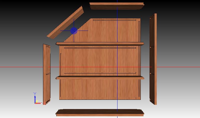

Kerry, one other thing I would add, If you are going to build this cabinet with blind dado construction, go to the construction editor and edit the tenon insets, otherwise you will get an error.

I noticed that you went to the trouble to show the miter cuts, would you tool up and cut those on the router or would you cut those manually? This isn't a cabinet that most of us would cut out very often.

Kerry, I would personally cut them on the table saw. I think from a time management standpoint, some steps can be executed better without the router. By the time I replaced the tool in the router, I can tilt the blade and be done.

Sorry, hit submit too soon. I was just playing around with the miters on this cabinet because I have a cabinet that I have to build this weekend like this. I have a house I am working on that has a laundry room with a staircase going up the back wall cutting an angle into the ceiling and has created the same situation for me as Brendon has. The bad thing is, I thought I was through with this house yesterday and the home owner says: "Hey, what about my laundry room cabinets?", All I could say was, "the builder doesn't have anything planned for laundry room cabinets, he has a wire shelve on the blue prints". Guess what, now I am building laundry room cabinets. The comunication process is not very good between the home owner and the builder. By the time I get the info, who nows what the H@** I am suppost to do. The builder tells me one thing and the home owner pops in and says something else. The only thing I can say is UPCHARGE $$$$$$ !!!!
