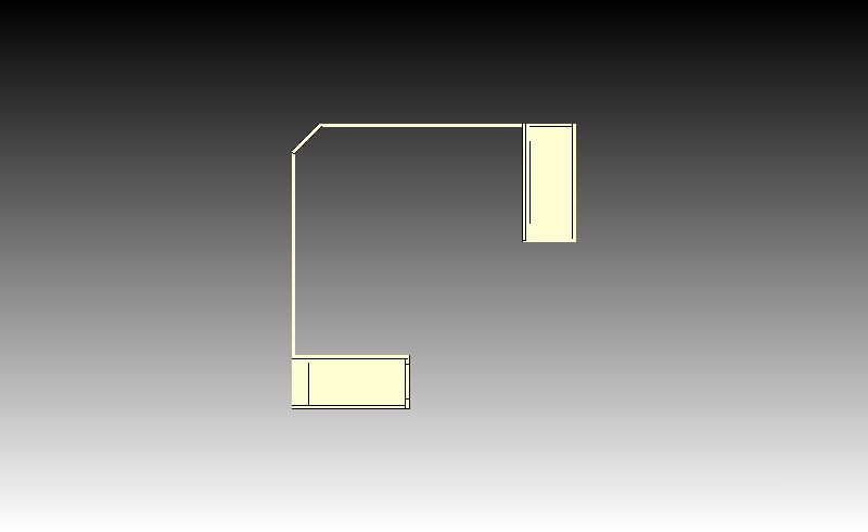

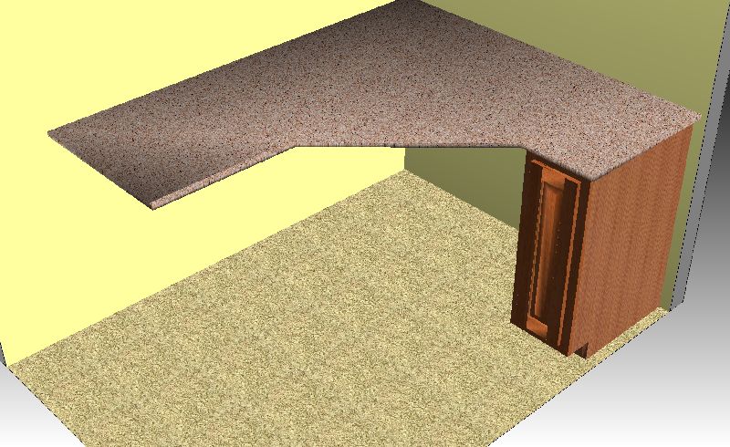

Stefan, I have run into this before. There are several ways to handle this, you could make a 3/4 x 3/4 cabinet and place it in the back corner to build the counter off of or the easiest way for me, build a angled front corner cabinet and delete all the parts except the sides and back. Place it in the room. The cabinets on either side of the corner, place a .75 scribe to the outside style and then slide the cabinet over the end grain of the corner cabinet to flush it out.
corner desk.jpg (45.4 KiB) Viewed 11211 times

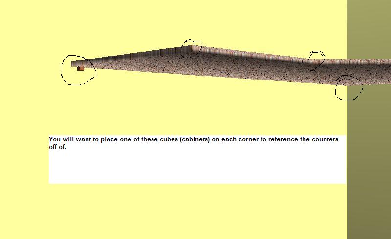

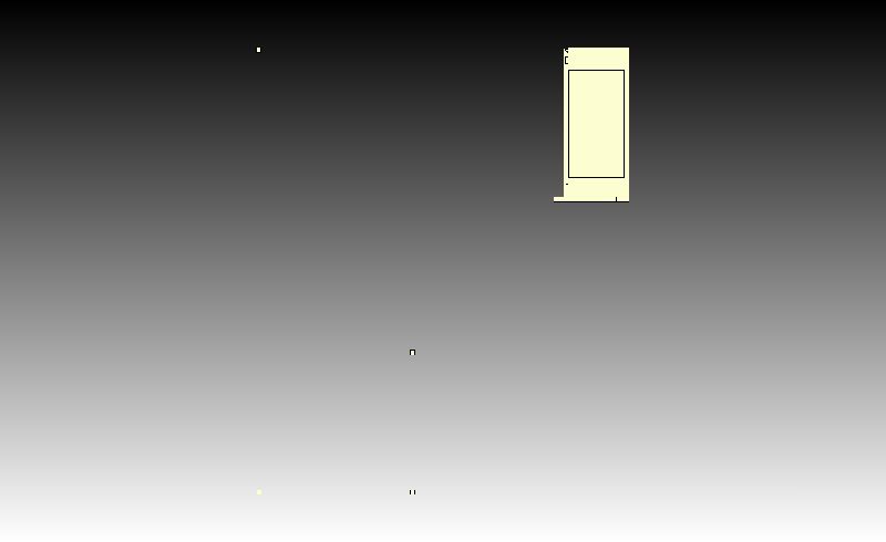

Here is the other way with a cabinet the has all the parts deleted except one side and change the size of the cabinet to a 3/4 x 3/4 cabinet, and make it 3/4 tall. You can use these cabinets to place in the room to build counter tops. I left one of the cabinets(3/4x3/4) showing so you could see it and the others I raised up into the counter top so they would not show.
corner counter top.jpg (14.92 KiB) Viewed 11203 times

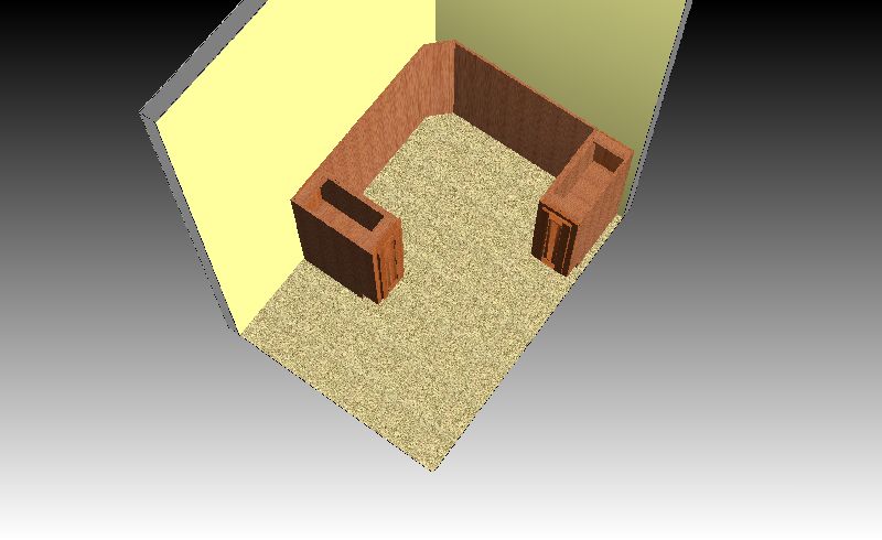

Sorry didn't load correctly
counter with .75 cabinet.JPG (27.97 KiB) Viewed 11196 times

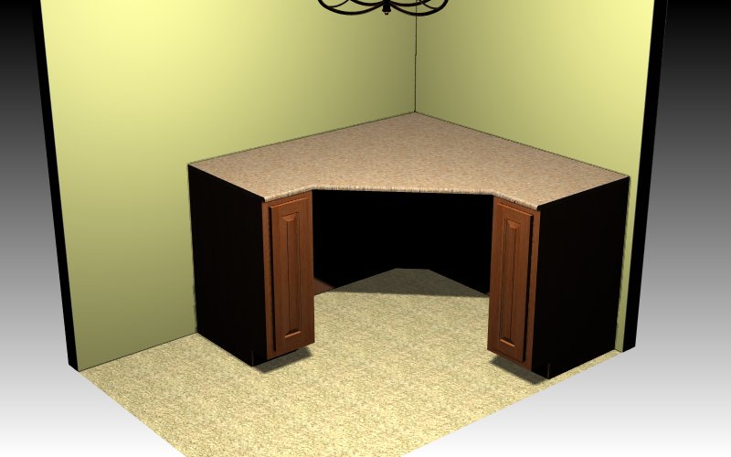

Why are you using the display cube?? Maybe I am not understanding something. I can build that desk as I described and then take what ever cabinet I want to use and place it freestyle under the top. You shouldn't have to delete any cabinets. This cabinet is tucked under the top 8" as you described.
corner desk.jpg (51.11 KiB) Viewed 11129 times
