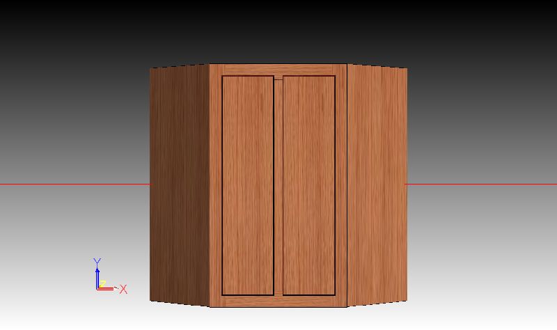

Patrick, you can do it but it is a little more complicated. You will have to manually place a display board in there and position it where you want it. If you are using a pair of doors, in the settings screen for your doors place a door gap the same width of your center style minus the overlay. Here is an example.

thanks Damon, I was thinking I had to do that, but hope there was a simpler way.
