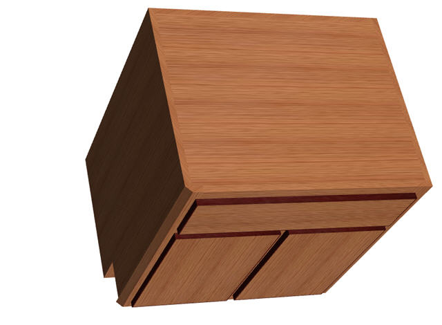

Re: Angled Corner
You are trying to do something like this, right?

Re: Angled Corner
Post by leigh mills »
yes that what im trying to do
Re: Angled Corner
I used the method described above to do that. Here are 4 different chamfer tools. Each will cut a different side on the part so you can experiment with them to see how they work.
They are all 3/4" so if you need something larger, just use them as a guide and create what you need in the Shape Manager.
