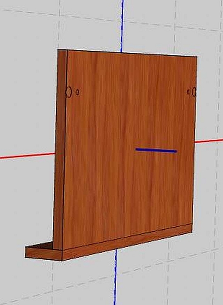

I need to know if this hole pattern will cut to a depth of .6299mm as I did it in the PE. It doesn't show any depth of cut in the pic. What I am trying to do is get rid of the RTAs at the front of the shelf.

Hi Wally,
Have you tried nesting this in eCabs then double clicking the part? Then below the part it will give you ALL of the dimensions of that hole.

Thanks Paul -- I nested it and it shows a depth of 12mm &16 mm for each hole respectively.
