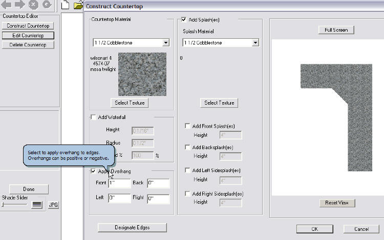

Wouldn't an applied overhang of the counter top of 25 inches or so to the appropriate side be easier?

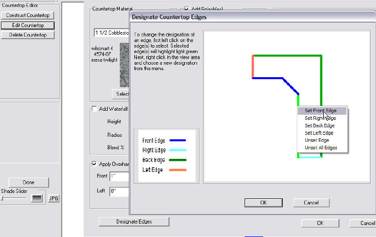

Thanks for the advice. I had not noticed the overhang box. That is what Lamar was talking about also I believe. I will have to do that so that I will have another way of doing it. You guys are a real big help. I really appreciate the forums.
