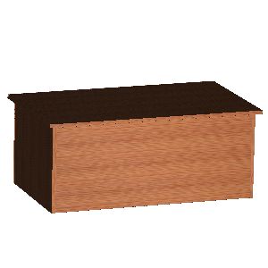

Attachments didn't work on the first post. Review this uncomplicated design for ideas.
Dale

cedar chest.hsf
(180.02 KiB) Downloaded 1050 times
