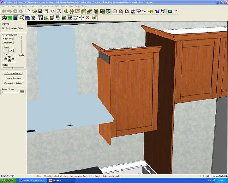

I always have a issue with the applied end panels on cabinets if I have to resize the cabinet. The attached pic is the latest. The cabinet was resized in highth. The applied end panels do not follow. If I delete end panels & re apply after the cabinet is resized I get what the attached pic shows. I will have to delete the cabinet & reinstall with a new one, then adding the end panel again. Anyone else had this issue?

Thanks for pointing that out Rob. I just came from site where my side panel was 100mm too short. Now I know why!
Re: End Panels on re-sized cabinets
Rob, maybe you could use a cabinet side as your panel? Just uncheck all the parts you don't want. And give it a user part name.

Could you attach your job when it’s in that state so we can take a look at it. At this time when you change a cabinets dimensions that have end panels the end panels will not adjust to the resize.
