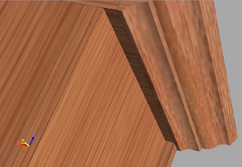

Would it work to do your crown like this Al? This is a separate cab above the faceframed cab with all the parts removed except the top.
crown over gable.esa
(318.02 KiB) Downloaded 400 times
crown over gable.jpg (50.69 KiB) Viewed 3972 times
