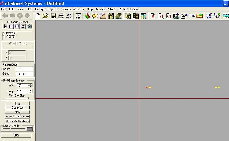

I have a contract to build several hundred cabinets and we need to be able to Assembly on site. I was thinking about the KD Fasteners. If anyone can comment as to the pros and con's of this type of fastener, it would be great. I don't want to find out 6 months from now that maybe I should have researched a little farther. The trial run I cut worked out good except I noticed that the stud hole goes all the way through the material. How or where do you adjust the depth of the pilot hole? All I can find is the spacing for the fastener.

Damon -- Open up the hole pattern that you are using and check the depth (on the left side ) after you DC on the hole to highlite it.

Thanks Wally, That is what I needed. I didn't think about going there to find the settings. Sometimes it is faster to just ask than search.
