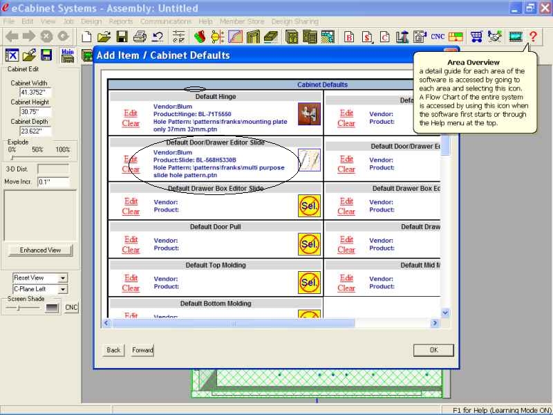

Where do they say , if they have a hole pattern.
Wally Schneeberger
Posts: 481
Re: Hardware hole paterns
Post by Wally Schneeberger »
Here---

Thanks Wally
