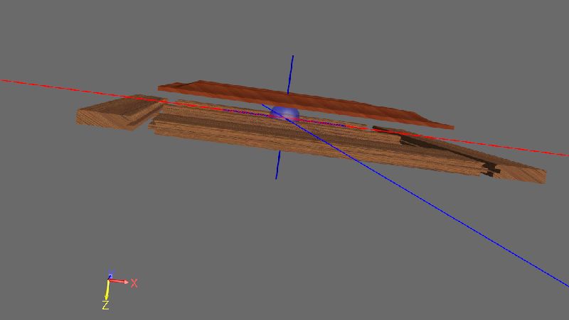

Re: Raise Panel
Gary,
Here is a sample of a raised panel end that I did all of the cuts using tools created in eCabinets. You don't have to do the stile and cope cuts unless you want them to display properly in presentation views. I use a face frame with negative insets on the rails the length of your cutter (either 3/8" or 1/2") and I use an mdf door with the panel raise on it. This way if will re-size and by changing mid-stiles and rails you can create different looks.
panel end.hsf
(2.08 MiB) Downloaded 640 times
