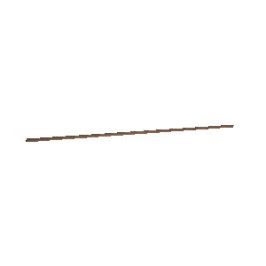

hi all, I created this crown and yet having a hard time creating the mitered corners, The crown is for an upper cabinet and has a return on both sides. Any help. thanks Mark.

Mark,
You will need to create a 45 degree mitre tool.
First, create the molding to your desired length.
Then, take the molding into the PE.
Next, use the 45 degree miter tool to make your mitre cuts on both ends of the part.
Then, go back into the cabinet editor and move the part into position.
Note: when making the 45 degree cuts, you may need to flip the part to get the desired cut.
