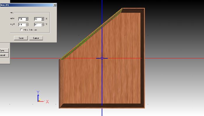

Yep you’ve got the jist of what I’m after, I’ve searched the topics and come up with this so far, but would like to angle the top, sides and display board and any shelves to neaten it up, I would really like to add face frames and doors also,
Many thanks
simon

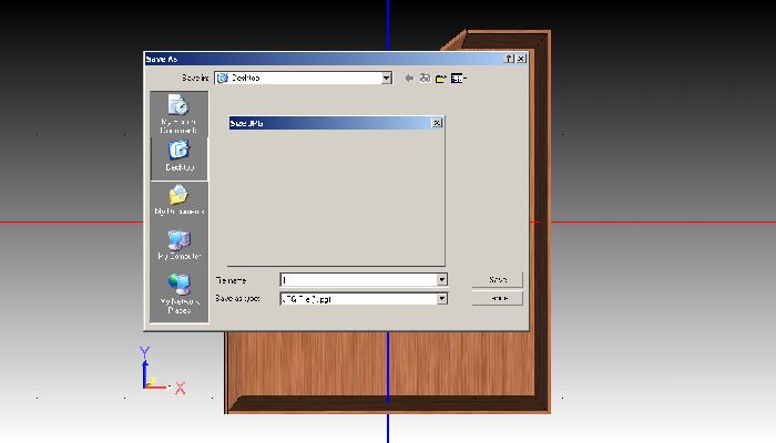

whoops sorry, think you can see this better

I foresee you getting to know thw PE really well. As all of your FF compenents and doors will need to be created in it. And they (doors and FF) will not update correctly when resizing the cabinet. So this is going to require a lot of trial and error.
TIPS:
- FF can be trimmed or mitred in the part editor.
- Slab doors can be trimmed in the PE, but the edge banding cannot be deleted or made transparent. Example: if you take a slab door into the PE and cut off the top left corner the square edgebanding will remain.
- Try using diplay panels for doors.
If someone else has had experience with this type of application, please post some tips! Thanks!
