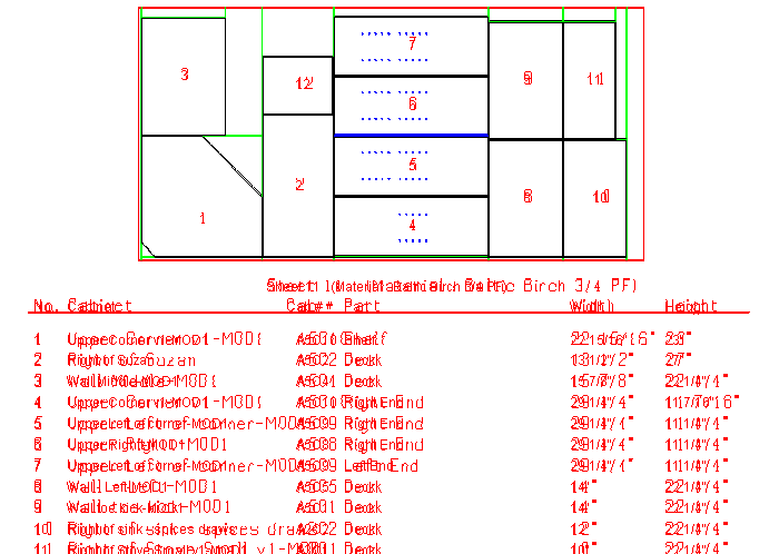

Has anyone seen this? It looks like I've got double vision. The print preview matches the actual print out. I need to start cutting tomorrow but these printouts are useless!

Does this happen with everything you try to print? If it is not, please send me jsut this cabinet or job file so I can reproduce this.

It's happening with any print out within the Nesting program. The labels printed fine, printing of the layout (room) view prints fine.
** Update ** for the heck of it I shut down eCab and restarted and it printed fine. Something I'm doing is causing it to go wacky after a bit but at least I've got a workaround. Back to the shop...

I have had this happen to me also, I restarted the computer and it went away. When it happen to me I did
use the filter to take alot out do not know if it have anything to do with it or not, This about a week ago
and its working fine now.

Please post one of your jobs that is doing this. I will try and print it here to reproduce the issue. If you filtered out certain things let me know that as well for I will ahve to do the same thing you are doing to get the same result.
