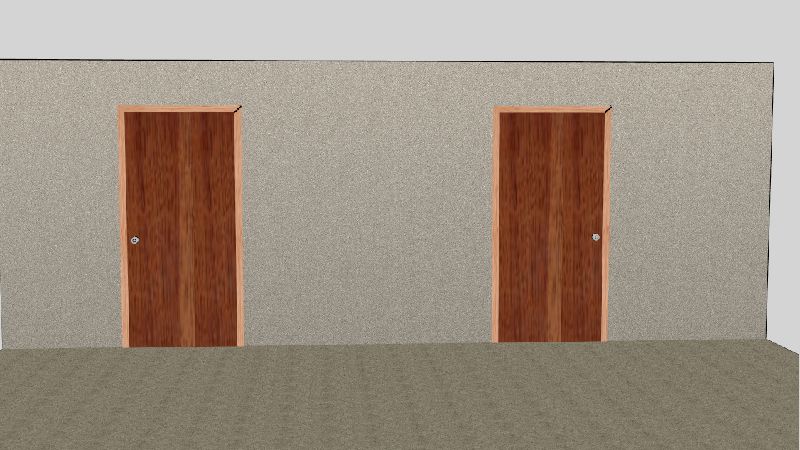

Re: Door detail ques.
Peter,
This has come up before.
For a right hand door place the door on the face side of the wall,
For a Left hand door place the door on the back side of your wall
Be sure and check the Apply to Both Sides box on the door dialog.

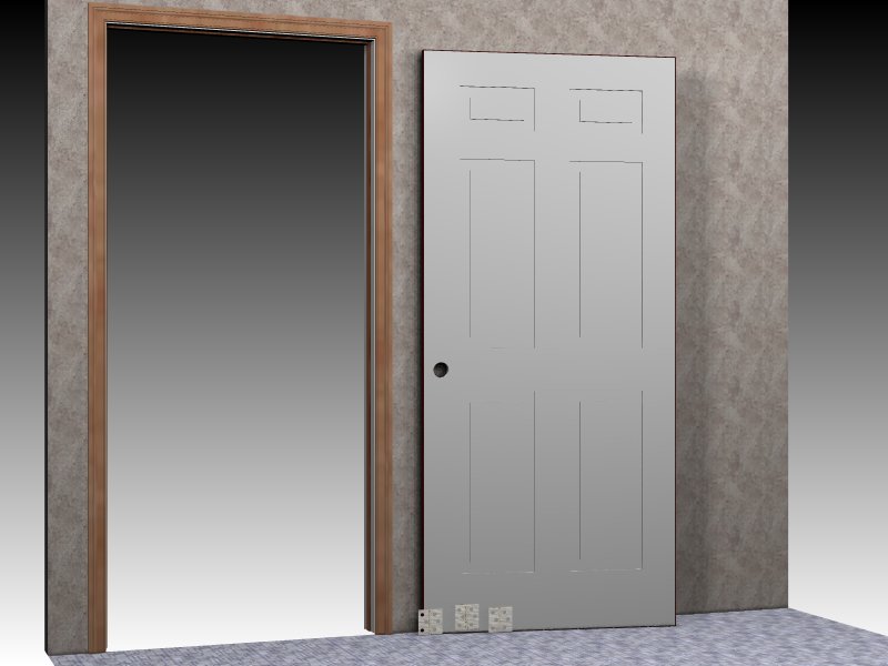

George, and Kerry great info as usual, and thanks for your time in helping us 'newbies' to make the most use of eCab.
(Now that I've got your attention I've got about a hundred more questions...well, a couple anyway :D ).
1-how did you get the casing to show on the wall, and how do you change the size/texture of it ?
2- where did you find the 6-panel door and are there others that can be used ?
3-I've seen room displays that seem to have crown or base or other moldings applied to the walls. This adds a lot to the realism of the presentation view; how is it done ?

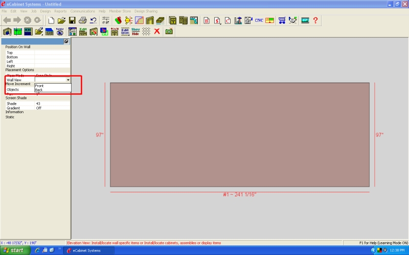

Peter,
With your wall in the elevation view look to the left on your screen and you will see Wall View
Use the drop down menu to choose front or back
Peter Walsh
Posts: 460
Location: Palm Springs, Ca
Post by Peter Walsh »
AHA!
Clever creatures those programmers.
