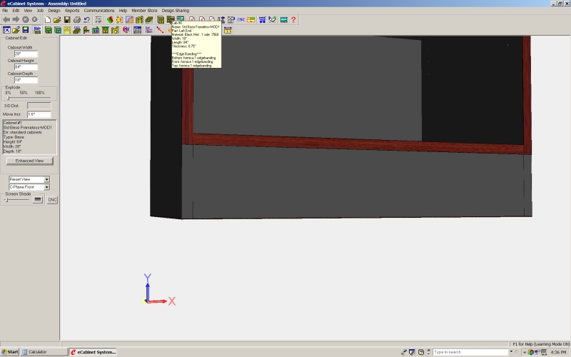

I am designing a cabinet with the toe kick inset set to zero so that it would be flush with the front. I applied the edgebanding to the raw edges of the sides and everything looks OK. Then I realized that I needed to inset the toe kick .0450 to allow for the P-Lam that will cover the toe kick to flush out with the side banding. When I inset the toe kick, the edgebanding moves up level with the deck for some reason. I can give it a neg. inset to move it outward and the edgebanding works OK.

Disregard the question. :oops: My wife was LHAO watching me try to get out of the shower to disregard this one. It hit me once I got the saw dust washed out of my brain that the sides inset with the toe kick which would in turn cut the edge banding short. I need to treat this as a stretcher instead of a toe kick.

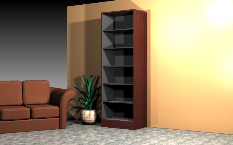

This is what they had in mind. Black Melamine interiors and Wilsonart Windsor Mahogany p-lam exterior. How would I work the ladder base on a single cabinet like this. I understand the long runs, I could build the ladder, level, and then install base units on top.

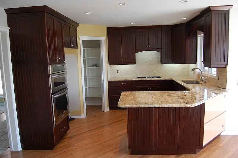

Damon -- The plastic levelers is all I use for my kitchens and I have never had a failure or even a crack in one. They support the cabs and a lot of weight with the granite tops. Even on islands and peninsulas I just screw them to the floor after leveling. Here's one I am just about finished.

Yes I use the snap on kicks and sometimes use glue and pin nailer for the corners. Also if they are being covered (tiled or ? ) then I brad nail right to the leg and to a cleat on the wall. It works just fine.
