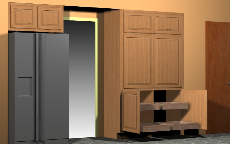

Or you could show the doors open by adding the doors manually with the drawers pulled out.
Damon
mcleod 11_10_08b (2).jpg (90.18 KiB) Viewed 10056 times

If I were to do your way would the doors show up on the cut list?
John Desmond
Damon Nabors
Posts: 923
Location: Marion, Ar.
Re: Adding Doors
Post by Damon Nabors »
Yes

How do you get such a good clean look to your cabinets. I really like the way it looked in the posted picture.
John Desmond
Damon Nabors
Posts: 923
Re: Adding Doors
What exactly are you talking about. This was just a basic cabinet with some pull outs. Give me some more details or post a picture of your layout and maybe I can see what your looking for. I am sure we can get you up to speed in a few simple steps. :)

I would change the textures on your sheet goods, If they have a lot of grain, they seem to pop out at you too much. Go for a little more subtle grain pattern.
