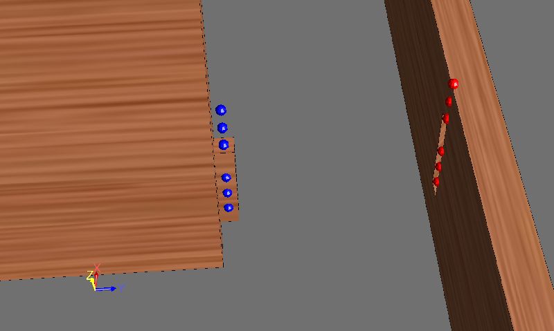

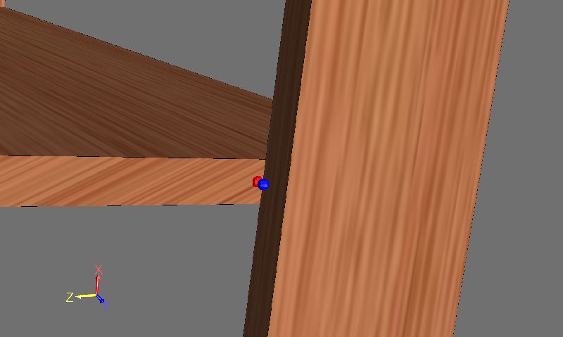

Just one question about the assemble marks. On this stretcher. It has assembly marks in areas where the material is not wide enough to have them so they run off the part. In this particular case, Part A will not cover the marks on part B.

Open the assembly marks editor find the stretcher and find the edge that has too many and click on the pattern. A drop box will appear and you can change its pattern but beware that you can change it to a pattern that is already being used by another part too.
Hope this helps.

Cool, thanks Walker. That will help.
I think I should be able to differentiate between the big parts and the little parts, so I should be able to make this work. I personally like this idea because I normally get mad at my assembler when the parts get flipped over. Me being the assembler most of the time. I am glad I have dual personalities so I don't feel like I am getting mad at myself too much. :joker:
