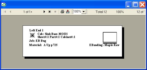

The labels (30252 address symbol.rpt) are sometimes designating the wrong edges to be edgebanded. The edges in the attached file are all wrong.

All of the parts are wrong in this cabinet.
Starting with sheet 1 part 1, the label designates the edge away from the operator gets edgebanding.
The nest diagram shows that edge to be the back edge of the Left end. (edgebanding was placed on the front edge)
Sheet1: Part 2:, label designates edge towards operator.
Nest diagram shows edges towards operator is back edge of the right end and banding was placed on the front edge in .hsf
Dave

This is the label I get for Sheet 1 Part 1. Is this not the case for you?

You are correct, it is not the case for me.
Here's my label report re-directed to a PDF printer.
Seagate Crystal Reports - LABEL.pdf
(8.57 KiB) Downloaded 1311 times

I found the problem. It had to do with your machine operating system. It will be resolved in the next update for Control Nesting. This update will also change the labels to read EB instead of EBanding as well as change the default for leave skin setting. Thanks for all the input and patience!
