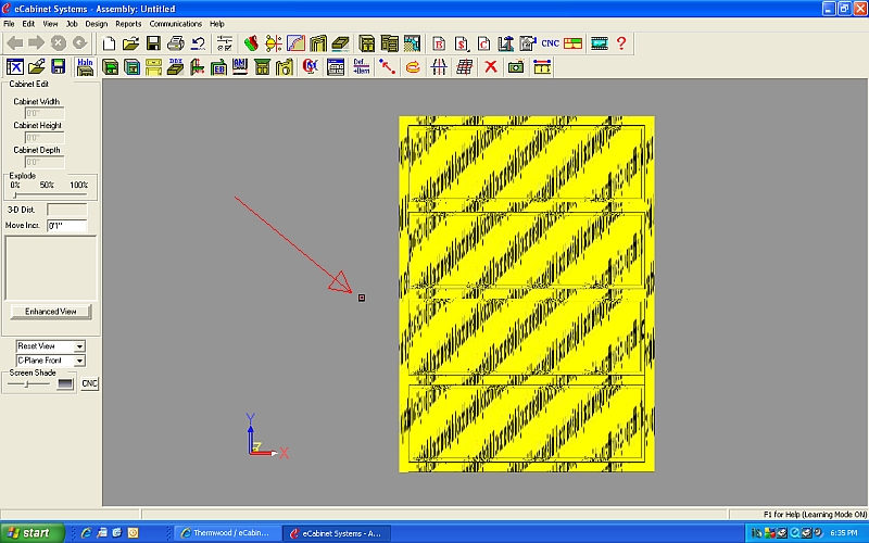

Gary,
I think I may have discovered why your cabinet is crashing the Display Part Editor
The Arrow is pointing to a Standard Base Frameless that I loaded next to your cabinet.
your cabinet scales somewhere around 112 feet wide by 149 feet high.
(Your cabinet lost it's texture when I loaded it in the Cabinet Editor is the reason for the yellow)

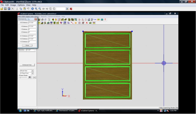

Re: Assembly Question
Post by Gary Puckett »
Kerry,
This is what I scaled the door to be
Door 2.jpg (101.11 KiB) Viewed 6267 times

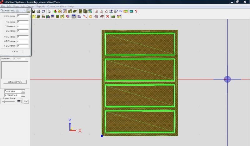

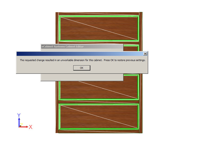

Gary,
This is what i get when I open your cabinet in the Display Part Editor
there is definitely something screwy with this. I would just rebuild it as Dan suggested.
