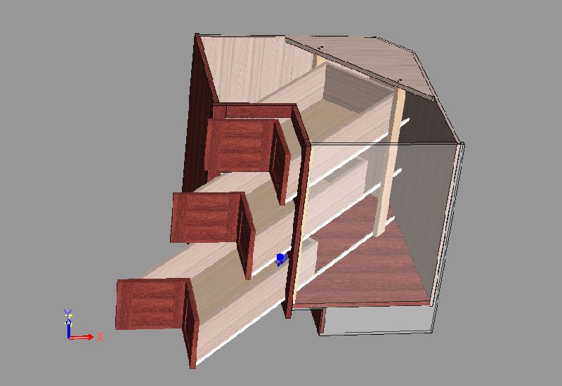

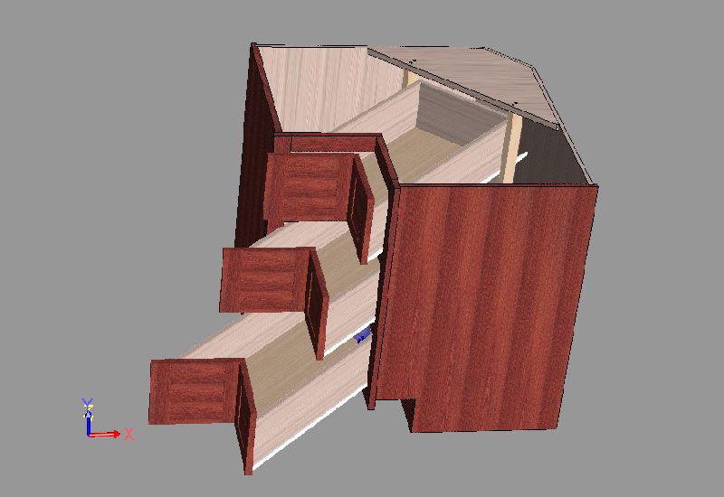

Re: Corner Cabinet Drawers - How?
Hi Donald I made this Corner Cab in 2007 for a customer a lot of work
Using display cubes
Cabinet Done 3-8-07.esa
(878.29 KiB) Downloaded 487 times
Corner cab_2007_1.jpg (45.8 KiB) Viewed 5377 times
Corner cab_2007_2.jpg (44.66 KiB) Viewed 5377 times

Thanks a million George!!!!!
This is exactly what I want to show the customer to see what they look like and how they work. It would be really neat if eCab V6 had this added to it since more and more consumers are interested in these types of corner cabinets instead of lazy suzan corner cabinets.
