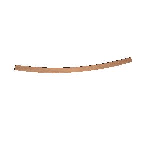

I wouldn't say I was a part editor wizard but I can maybe help on this one. I usually use a CAD program to draw the radius parts up and then save it as a DXF file. Create a display panel and take it to the contour editor, right click and select Load Geometry, then select the DXF file you created. Take it back to the part editor, right click and select Create Part Using Closed Contour, click on the pattern and you have your part. I attached a zipped DXF file I created which is approximately 95" long with an inside radius of 227" and an outside radius of 231".

You sound like a wizard to me Jon. And that's exactly how I do it.
