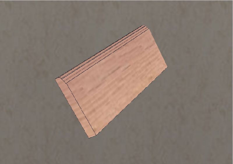

Got it! Thanks. Got one more questions tho: I like to put a 5" base around built-ins and furniture pieces - none that size are available as moldings...how could you make that work?

You will need to place the size of the molding you want on the cabinet and then click on it and take it into the parts editor and use a tool to put an edge on it. Then return with a save. I made this one, which is what I think you are looking to do. Watch the videos the have to do with the part editor that are on the opening page of ecabinets at the bottom. It will show you how to do this. You can use any tool you want to get the look you want.
