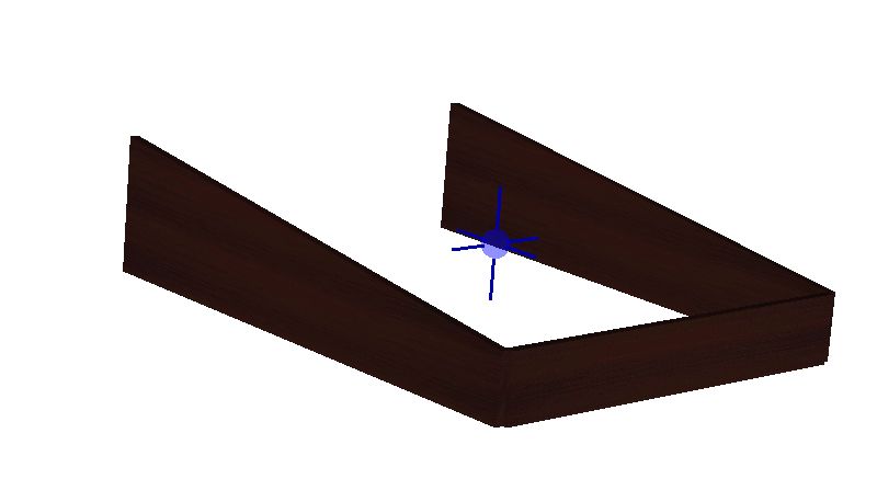

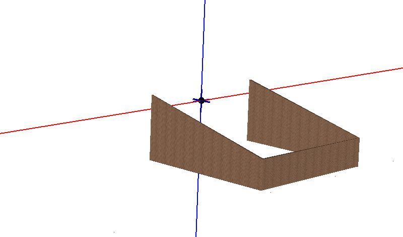

This is what I am wanting to do.
This was made with sheet stock I was wanting to make it out of board stock so I could get a accurate material list.

Gary,
It seems to me that if you don't take it to the Display Part Editor, you are done with one exception and that can be overcome. It won't be displayed in board feet on the cut lists. If you need that, then you'll have a little math. But it can be nested, if need be and cut on a CNC. And you can get measured drawings of the components.
Dennis
Re: Question about an assembly
Gary,
This was done with display boards and it rotates fine and I get a board foot tally in the cut list.

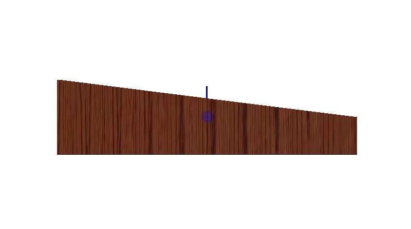

Kerry,
The wood grain has to be running up and down, not from front to back, so It is going to look kind a like a fence.
Gary,
Just switch the width and length dimensions of your board. This board is 12" long and 48" wide.
