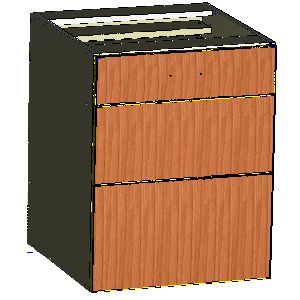

When I've set up constraints on a part, I've always deducted edgebanding thickness, when applicable, to get the correct results. I've done that, on the pull holes, on the top drawer front, of the attached cabinet , but when I take the drawer front into PE, or nest it, the pull holes are located the thickness of the edgebanding too close to the edge that they're constrained to.
It's entirely possible that I'm missing something, but I do think that something is off.
