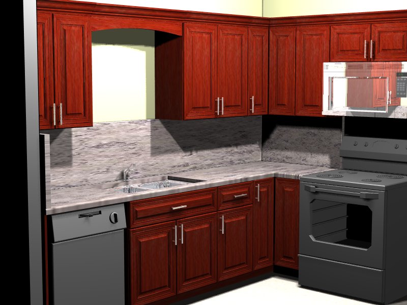

Well it won't allow me to post .twd file and the actual job file exceeds the size limit.
Here is a picture of the job, I wonder if bringing my cabs in from the old version has something to do with it. I hate to have to start over but I'll try building on the V6 library and see if I still have an issue.

Aaron
I'm getting a funky cut list from your file, too.
The quantity for the 3/4 Birch 1s is showing as -2147483647 which is definitely not correct. You can see the doors on the cutlist, which is because you've got them applied as 'build in house' so they won't show up anywhere but on the cutlist... if I remember that right.
Don't know what's causing the birch to be off....
jnr
Josh Rayburn
Hall's Edge, Inc.
CNC Machining Service
Dell Precision T3400
Josh Rayburn
Posts: 1263
Company Name: Halls Edge Inc
Location: Stamford, CT USA
Re: V6 Cost Sheet Not Diplaying all components
Post by Josh Rayburn »
Something to do with that Birch I think....
I tried to nest your job and got only blank screen. Deleted the side-by-side fridge (which is known to be problematic) and no change.
Then changed all the 3/4 birch 1s material to one of my 3/4" materials I use all the time. That seemed to do the trick.
I now get a proper cutlist (I think, I didn't look too close at the job)
See if changing that material helps you to get the sheet count from the cutlist - as far as the hardware items, the cost sheet seems to be working, I just don't know how many you're really supposed to have.

FIXED: Thanks, changed the sheet stock and all seems ok now.

Aaron,
I see that you said it is fixed based on Josh's advice, great.
I found that there is a problem with the ASSEMBLY cabinet over the sink that is causing the issue. If you take this to the Cabinet Editor, select the cabinet by double clicking the crown molding (high-lite the cabinet green), then remove Part Editor cuts. Not return to the room and all is well with the cut-list.
I am unsure as to why this is the case, but I thought that I would let you know this solution as well.
If there is a Part Editor cut on this cabinet, then maybe something there is what is causing the problem.
