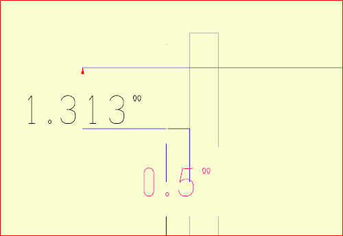

As reported in V6b1 there are issues with using constraints to PE cuts in the Draw box designer. Steps to repeat:
CE main
Select Draw box designer
open standard draw box
Const Sett>>global change material to 16mm Horizon
Change method to full dado, depth.3
select OK allow to refresh
Const sett>>back change bottom inset to .5, change dado depth to .25
pan to make back visible, select, take back to DBPE
place rectangle over each lower corner, apply cut thru to geometry, select main, apply cuts
select back again, take to CM
in CM set Horizontal to .5 on both cutouts, set vertical to 1.313 on both
Top (page view top) cut lowers outside of part instead of raising cutout see below:
DBE Error.PNG (9.37 KiB) Viewed 2751 times
You can see that the dado rectangle is still at its original height, but the side height has been reduced.

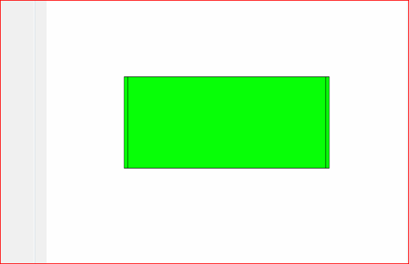

When these settings, even tho erroneous, are accepted, refresh throws DBE to my other monitor and sets the drawer to look like this:

Let me add that:
When window with green draw box was moved to main screen, drawer rendering dissappeared
clecked on it a few times and shook it with the mouse and draw box reappeared, saved file
when DBE "CLOSE" button is selected, it closed eCabs
Gary Campbell
