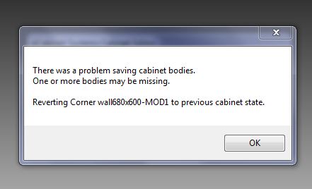

I can add shelves to frameless CNR units in the cabinet editor directly from the cabinet editor and save. But when I take wall or floor corner units from room layout to the cabinet editor and try and add shelves I get an error message and cannot save the changes.

Error message
Error message
add shelf problem.JPG (22.69 KiB) Viewed 4916 times

Your upper corner cabinet worked OK for me. I had problems with your base corner.
To fix your base corner
Take your corner cabinet from the room into the cabinet editor
Double click the cabinet to select it
Right click and choose
Remove Part Editor Cuts/from entire cabinet
Click yes to the prompt
The cabinet will re-generate and fix the missing part bodies and you can then add shelves
This will remove any part editor cuts you have done and you will have to redo them.
I think the problem placing your cabinets 2mm below the wall line may have something to with your having walls that are only 2mm tall. I think this would confuse the software.

I think the programmers have found a certain sequence of moves in eCabinets (I can't remember exactly what) that can cause a cabinet to lose "Part Bodies" The loss of the part bodies to the cabinet in your room is what was causing the problem with your cabinet. Removing part editor cuts and letting the cabinet re-generate fixes this problem but if it were a cabinet with a lot of part editor cuts it could be a bit of a problem to fix.
I think they have found a fix for this.
