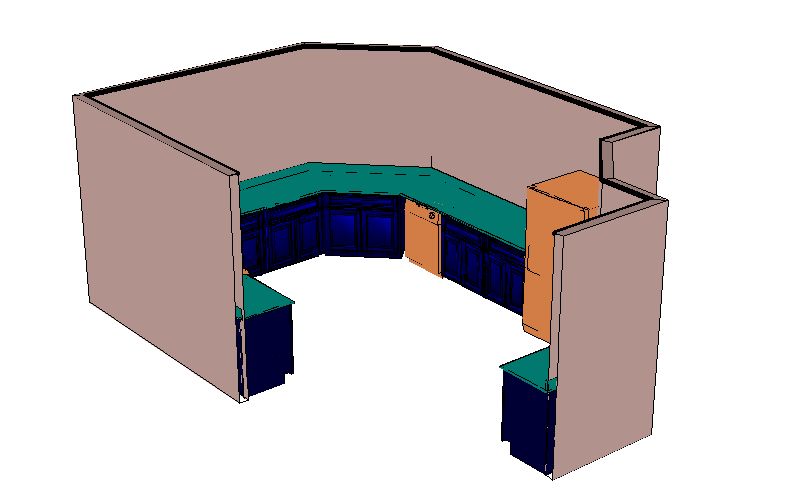

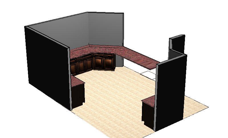

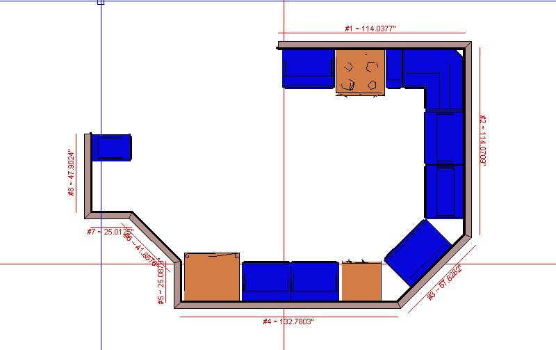

I'm working on designing a simple kitchen layout in V6B2. I can rotate design view and see everything intack on walls. When I go to Presentation mode a wall, its cabinets and appliance do not show up. I know they are all there but for some reason can't get them to display. I've done all the association stuff to no avail. Is this a known issue?

Don,
Mark is correct, you have hidden a wall while in render mode. It will also make any cabinets etc. associated to that wall disappear when you render the view with the wall hidden.
