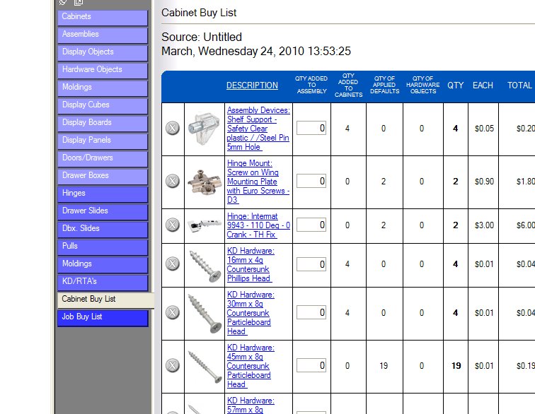

I have associated a shelf support to a cabinet (or the shelf I can't remember)
How the heck can I delete it? I can understand the hinge issue of Donald's, but how do I delete a random piece of hardware especially if I can't remember how or to which part I added it.
The GUI really should allow for a user to simply delete it at the Cabinet List window and jobs done.
Sean
how do I delete the shelf support????
eCabs delete hardware.jpg (93.44 KiB) Viewed 9647 times
Re: Can't get rid of hardware
Sean, hi-lite the cabinet first, then you can adjust the quantity of hardware in the Buy list.

Yes, I had already tried that. But when I save the cabinet, they keep coming back again. Any other ideas?
Sean,
If your hardware was added as part of another operation like hinges and mounts that are added with a door or slides and mounts that were added with a drawer front or box you will not be able to delete them from the cabinet buy list. Any other hardware can be deleted by highlighting the appropriate cabinet (by double clicking it) and then entering a 0 in the quantity added to cabinet box and hitting Enter.
The Items that cannot be deleted in this way will be showing in the Quantity of Applied Defaults column and not the Quantity Added to Cabinet Column in the Buy List. These Items must be removed in their appropriate editors.
If this doesn't work post one of the offennding cabinets so we can look at it.

It could be that the parts are being added as part of the assembly as well. Saving the cabinet does not alter the assembly defaults. Just a thought.
As Ketty mentioned, still having problems, post the job and we can see what is what.
I said that I had tried that and I swear that I had and it didn't work.
Tried again today, and it did work. :oops:
Maybe it was just one of those things, but most likely it was probably me.
