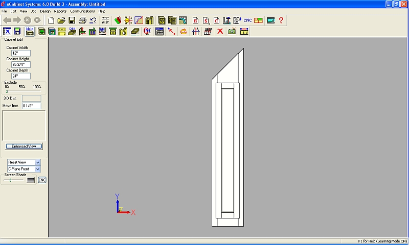

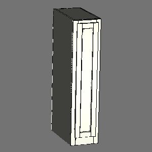

I would like to create a pantry cabinet that will fit under some stairs.
It would be like the attached cabinet, except that the left side would be 52.5" tall, and the right side 62.75" tall.
I'm not sure how to get this to work out for the top face frames.

Rob,
This isn't perfect but you can look at the construction settings and see what I did. This requires some Part Editor work. I made the top rail wide so that you wouldn't have to make a door that follows the slope.
