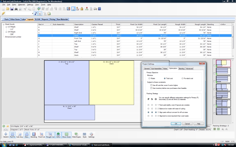

What I do is export my cutlist to excel and then I import that to cutlist plus. I have more control of the sheet layout in cutlist plus.

Gary, I haven't used Cutlist Plus for quite a while now, but it seems to me I tried to import Ecab cutlists a couple years back and never got it to work. Would you mind sharing your procedure to import those excel files, I may want to give that another try myself. Thanks

Go to Cutlist Plus web site, click on support tab, then click on Cad importing tap, then click on eCabinets instructions. It takes a little bit getting use to but it is not all that bad. I tried to post the instructions for you but when I re sized it to the 800 X 500 pixel size it was to blurry to read.

Here are the instructions These instructions are for the silver and gold editions, the platinum edition is different.
Clipboard01.zip
(382.12 KiB) Downloaded 945 times

Thanks Gary, for some reason, unknown to me, I believe it's doing the same thing that it did to me before. When I import from excel it shuts down Cutlist Plus (gold edition). I'll have to play with it some more this evening. :wall: Thanks for your help.

You have to close excell before you import to cutlist plus. It will not work if excell is open.
