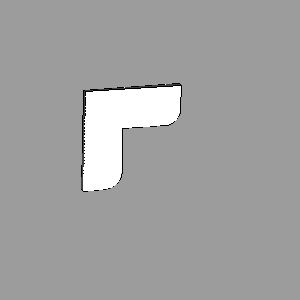

Hi,
It's been some time since I have had to put a fillet onto an internal corner and was left scratching my head after I couldn't get it to work. The attached shelf needs a 50mm fillet on the internal corner the same as the two external corner fillets which works as per norm. But when I went to fillet the internal corner nothing happens. I have done plenty of these on previous versions of eCabs and was wondering if this is a program error. Can anyone shed some light on whats going on here?
Dale

Dale,
This has been broken in version 6. It has been reported several times but I was told it isn't very high on the "Fix" list.

Fixed in next release

Doing a fillet on an internal corner does work in the contour mode.
Create the edges of that part the fillet it. That should work in the mean time.
