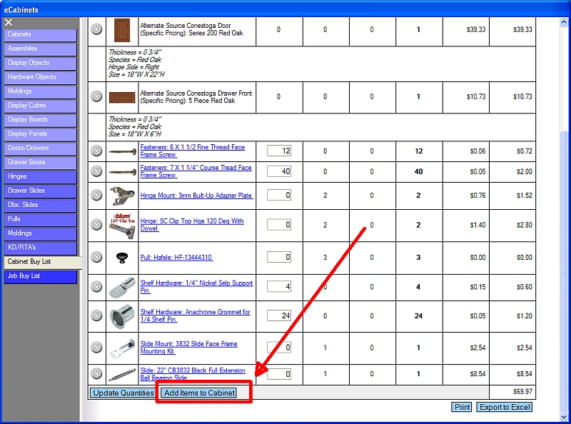

Re: slides and hinges
Lorin,
If you add a door or drawer front to your cabinet it will add any associated hardware and hole patterns to your cabinet automatically. If you want to add other hardware items to a cabinet to be saved be sure to double click on your cabinet in the Cabinet Editor to select the cabinet (green highlight around the entire cabinet) and then click Cabinet Buy List in the Item window.
In the Item Window make sure you are clicking the Add Items to Cabinet button at the bottom of the page and not the Add Items to Assembly button at the top.
Clicking Add Items to Cabinet will save the items with the cabinet
Clicking Add Items to Assembly will only save the items if you save the cabinet as an Assembly.
If you select the cabinet in the cab editor and use the Add Items to Cabinet button you shouldn't have any problems.
