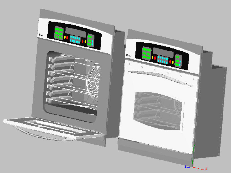

I have this single wall oven, and I need to explode it to be able to change the texture on some of the parts. I just don't know how to do this. I have proge Cad 2009 smart and I just can't figure it out. I would really like for some one to explain to me on how to do this, it is something I want to learn. Do I explode the whole oven or just the part I want to give a new texture to? Then once it is exploded how do I add layers.

Oven 5-16-10
In STL's
You are going to need a new (DOOR) it was no in the box :joker:
STL_wall oven 5-16-10.zip
(153.93 KiB) Downloaded 1602 times

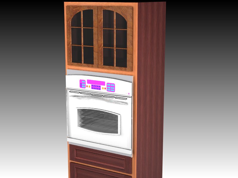

Oven Cab Tall 5-16-10_2.jpg (48.91 KiB) Viewed 25798 times

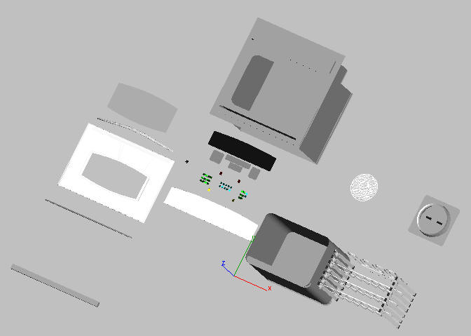

O here your parts

Thanks for the reply but I could explode everything with no problem, I just didn't know how to get the different layers after I exploded it. I finially figured out you just start taking the item apart and start saving the part that is on the screen, then rebuild it and put it all back together. A lot of work.
Re: How to explode
Gary,
That is the way it is done and it is a lot of work.

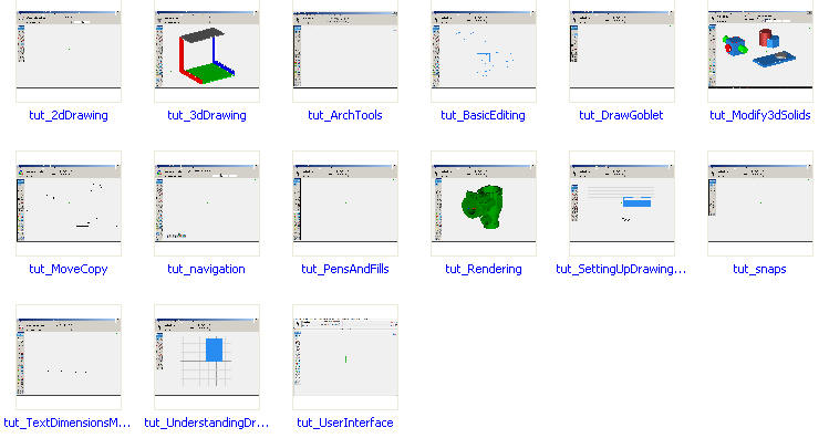

Videos for Punch! ViaCAD Pro v6
http://my.imageshack.us/video/my_videos.php
Videos for.jpg (51.3 KiB) Viewed 25703 times
