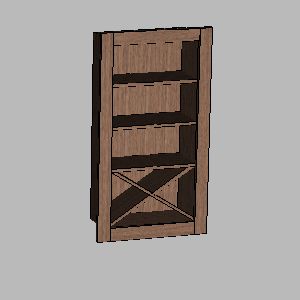

Hi Guys!
Here is a cabinet that I need to CNC. I don't know how to cnc the diagonal shelves.
Any ideas?
-John
Vanity Cubby.esa
(608.02 KiB) Downloaded 361 times
Vanity Cubby.jpg (9.18 KiB) Viewed 4621 times

Re: How do you do this?
Post by Gary Puckett »
You will probably have to old school and use the tabel saw.
Post by Josh Rayburn »
You can profile the edge of the shelves with a 45 chamfer tool, and use that actual tool to cut it. There are some funky settings and things you have to do to get it to actually work, but I've been successful. There actually was a good post about this a while ago, you may be able to find it with a search. It was explained better in that post than I can explain it....Let me know if you don't find it.....

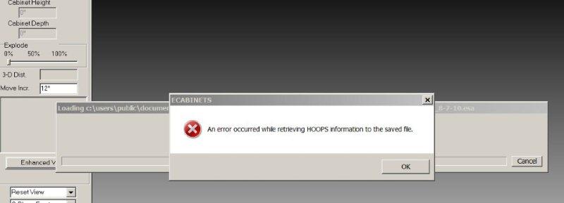

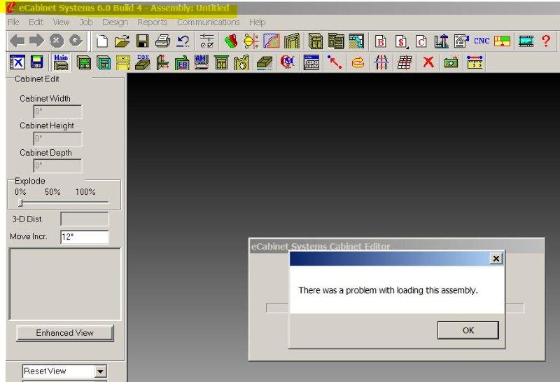

Hi John
I could not open the esa on my computer
Will not open LOADING.JPG (54.22 KiB) Viewed 4453 times
