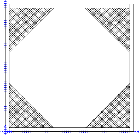

I have a number of platforms to make that need angled gussets at the top and bottom. Is there a way to do this in Ecabinets? Not the end of the world if I need to do them as separate pieces, added to the batch list, but I wanted to see if there was a better way first. Sketch attached of top view of platform, hatch patterns represent the gussets. Thanks.

Do you just need the part? If so take a panel to the Part Editor. Or do you need the joinery too?

Take a look at this Nat, and see if it would work for you. It is re-sizable, and will nest.
Platform with Gussetts.hsf
(236.02 KiB) Downloaded 417 times

Rick,
That's what I was looking for, thanks very much.
