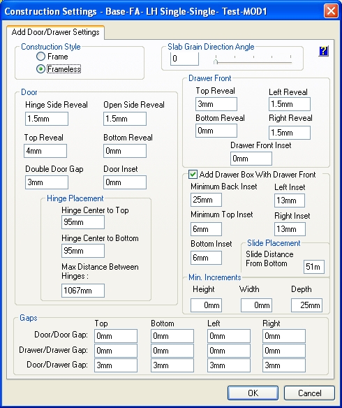

Here is how I got the numbers you want. I am not sure why it works but it did.
Use these settings in the Door/Drawer Front construction settings
Select the drawer opening and add your front 157mm tall
Select the door opening and add your door
Even though I show a 4mm reveal on the top door setting you will just have a 3mm gap between the door and drawer front.
Re: door editor help
You can also use these settings and you don't have to enter the drawer height manually.
Notice the gap settings removed.

Thanks for the screen shots Kerry. I played with the reveals as per your suggestions, and eventually got the desired front sizes. But this method of trial and error seems awkward and un-intuitive. It'd be nice to understand how the software uses all the reveal settings to get the correct door size. I can just imagine looking at these "wrong" reveal settings and changing something to the "correct" setting and messing everything up. Why does a 17mm bottom reveal on the drawer work out to an actual 3mm?
Joe,
If you select the top opening and have 0 reveal for top and bottom on the drawer front your front will be the size of the opening plus 18mm for the top material and 18mm for the stretcher material.
Opening 141mm + 18mm top + 18mm stretcher = 177mm
-3mm top reveal = 174mm - 17mm =157mm your desired drawer front.
You wanted a top reveal of 3mm hence the 3mm top reveal setting. The 17mm bottom reveal is what it then took to get the size of 157mm that you wanted.
With 0mm top and bottom reveal settings your door will be the size of the opening plus 18mm for the bottom material and 18mm for the stretcher material. You want a 0mm bottom reveal so we leave that at 0 and you want a 3mm top reveal so we need to shrink the door by 1mm that the drawer front drops onto the stretcher material and then 3mm for the reveal you want making it a 4mm reveal setting.
Opening 573mm + 18mm stretcher material + 18mm deck material = 609mm
-1mm that the drawer front covers on the stretcher - 3mm you want for reveal between drawer and door (4mm total reveal setting) - 0mm bottom reveal =605 your correct door size.
The reveals are calculated from the outside edges of your opening size plus your material thickness.
You don't want a gap setting on this. Gap settings are for when you don not use a stretcher.
Hope this helps
Post by Joe Pyle »
That helps a lot Kerry. I'm just one of those guys that isn't satisfied with just knowing, I need to understand what I know. I should be able to get somewhere now.
