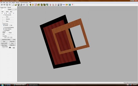

Kerry,
This is what I get when I open your hsf file
