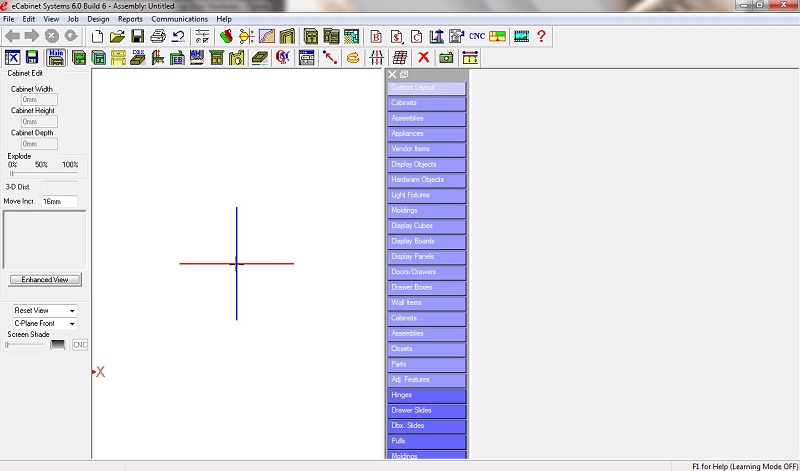

The item window seems to have crashed, is there some way to reset it?
It is completely non responsive.....
I have tried restarting eCabinets, then windows and eCabinets, but it loads up like this.
Any recommendations?
I have a job to complete, and this isn't helping much at all. I think its time for a bourbon. :wall:
Crashed Item window
Crashed Item window

Just noticed, that he main menu doesn't appear when you first start up.
