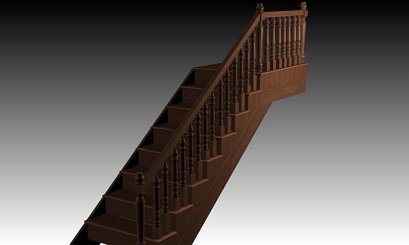

Re: Need to draw steps
Stairs Plan
You will need to resizes them to what you want
