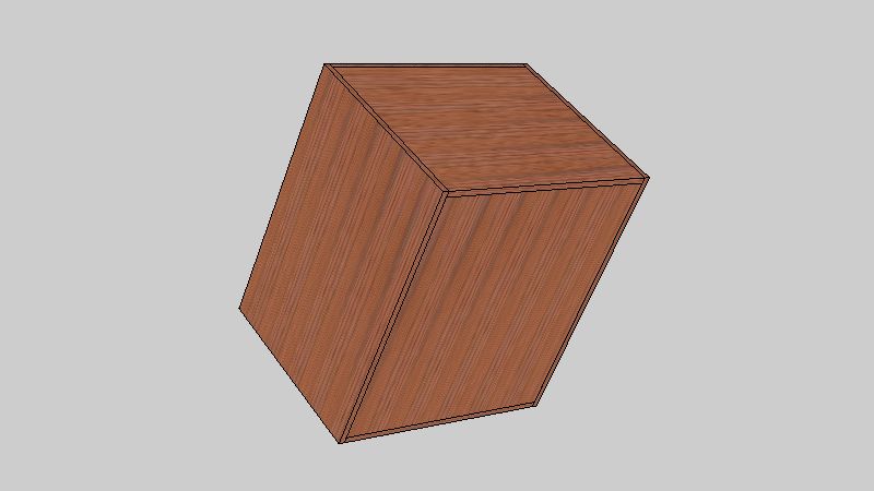

Does any one have a seed cabinet that is a box enclosed on all sides? If not what is the best way to accomplish this?

You can make this by putting a face frame on the front of a standard cabinet with or without a toekick. Use a "left stile" or "right stile", or you can use a "top rail" or "bottom rail" - the problem is that if you change the size then you have to change the width of that face frame part manually.

Just use a stretcher for your front.
Lock your positions and it will re-size with the box.

Here is the cabinet if you want to look at it. This is all butt construction but you can change it to any joinery you like.
