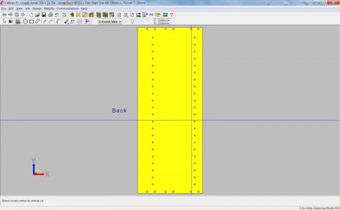

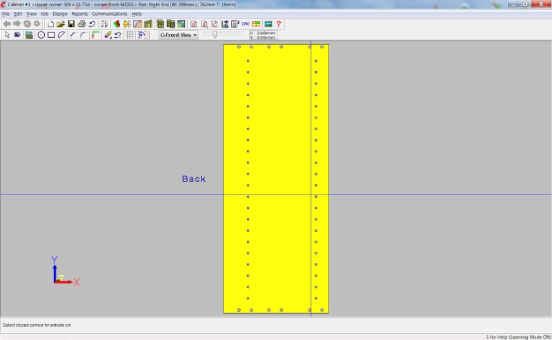

Here is the justification for this feature request:
That attached picture shows a cabinet side that I am adding 5mm hardware holes to. With the current PE mode to create geometry cuts, I have to click the mouse 44 times for each end of the cabinet (88 clicks - I'm getting carpal tunnel
 ) so I can create the cuts.  With the ability to stretch a window around the holes I want to cut, it would be click, drag, release.
HUGE time savings!
