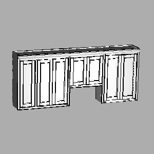

I have a complex assembly that took a while for me to put together. Now that I need to do some final adjustments it is acting wonky.
I need to make the left door opening of the left cabinet of the assembly 1/16" larger but when I bring it into the FF editor it gives me some crazy opening measurements.
The height is -200"
the Width is 282 27/32"
Here is the assembly file.

Scott G Vaal
Re: crazy dimensions in assembly
Post by Scott G Vaal »
Leo,
Interesting situation. It took me a few minutes, but I have finally reproduced what you are seeing. If you take an assembly of cabinets (that have face frames) from the custom layout area to the cabinet editor, you will get these goofy looking FF section sizes. It appears to only do this when taken from the CL, loading the assembly directly into the cab/assm editor or from the batch will not present this anomaly. I will get this listed and fixed. For now, If you need to modify an assembly cabinet from the custom layout, you can regen the cabinet (select Construction Settings and then select OK) first and then go into the face frame editor and the section dimensions will show correctly.
