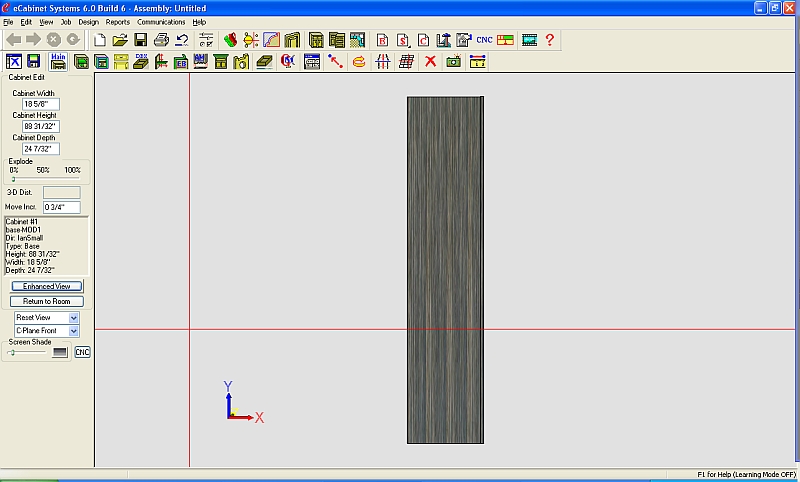

Did you know that your sideways material displays the grain running vertically with the length not cross grain?

Weird again - it works for me (once I corrected my door material choice). The cross-grain material (Oak rift - dark ceruse sideways) appears on the nest diagram correctly. When mounting doors, I have to change the grain 90degrees so it goes horizontal. Same is true for the cabinet sides - in const settings I rotate the grain 90 degrees. It's all nesting correctly.

If I rotate grain everything works fine. What was the purpose of the sideways material?
