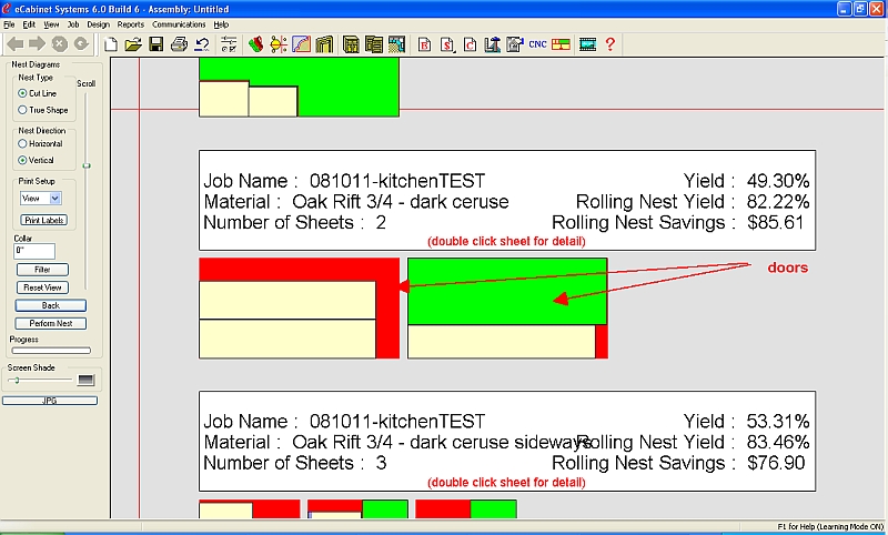

Hey Kerrie - that's strange. The doors are supposed to be cross-grained. They should nest with the "dark ceruse sideways" stock, not the plain old "dark ceruse" stock. So something still ain't right....

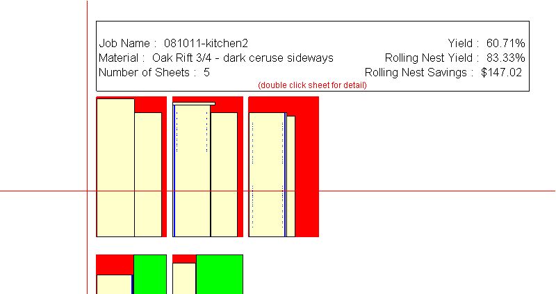

The doors are not out of the sideways material when I load the cabinets from this job. If I delete and re-add the doors using the sideways material, it nests them OK for me.

Ok, starting to make more sense - I had incorrectly made the doors out of the standard 4x8 stock, not the cross-grain 8x4 stock. So I was unable to nest the tall doors properly. However, it seems weird that when you guys loaded the job, the doors weren't mounted cross-grain, and went ahead and nested properly.

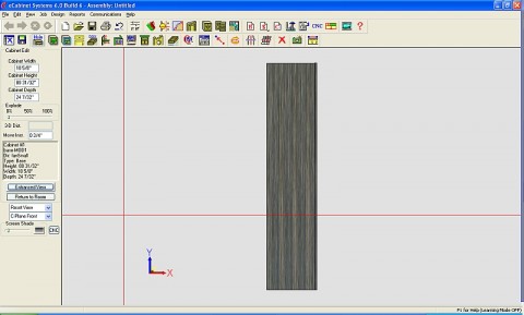

Did you know that your sideways material displays the grain running vertically with the length not cross grain?

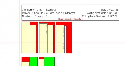

Weird again - it works for me (once I corrected my door material choice). The cross-grain material (Oak rift - dark ceruse sideways) appears on the nest diagram correctly. When mounting doors, I have to change the grain 90degrees so it goes horizontal. Same is true for the cabinet sides - in const settings I rotate the grain 90 degrees. It's all nesting correctly.
