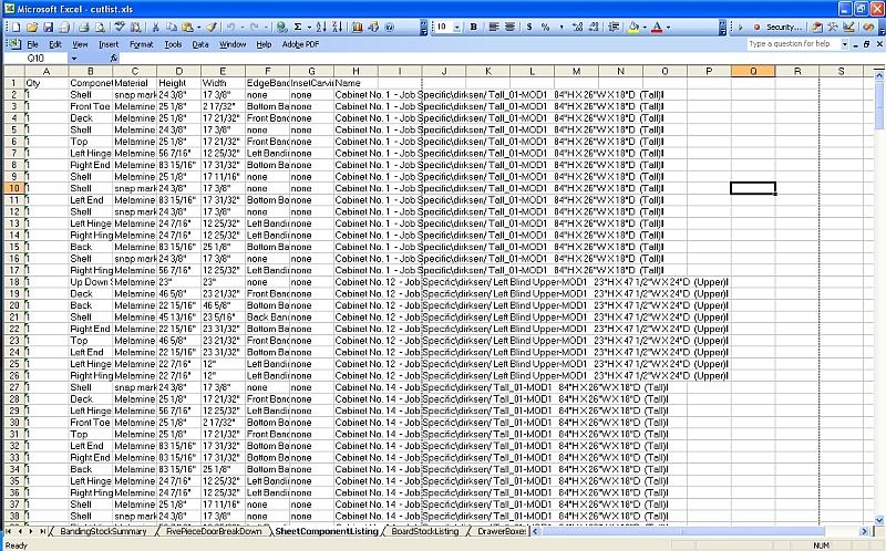

I am using the import to excel in my batch's and find it's great for the board stock cut list only problem is to much information. I need only material, lengths,widths, component, and cabinet it is associated to. PERFECT! Problem I have is the cabinet No. is not necessary or the clients name or the total cabinet dimensions, or if it's an upper or base.
I have tried but I just don't excel at excel. Have any of you guys been able to manipulate this information can you help me to get only the information the guy needs to simply cut face frames without going blind looking at redundant information.

Anyway, I have the same problem. The cells in excel have string format, not numeric. It is not possible to convert them into numeric automatically, because they are in millimeters, but if the length is bigger than 1000mm it is in meter. I can't describe how annoying this issue is. How can I customize the cutting list? Much less information would be much better in my opinion. Also, is it possible to get rid of the annoying cabinet part names and using only my own?

You have to use features of Excel to clean up your cut list such as the find and replace to get rid of your excessive cabinet names. You must also use this same feature to eliminate the quotation marks after all the numbers. After the quotation marks are removed you can then convert the numeric text to real numbers, (I don't know about the millimeter/meter problem as I convert to Imperial inches and fractions.) You can remove any unwanted columns and then sort and arrange the information to suit your needs. Once you have figured all this out you can record a Macro to automate this procedure.
This all takes some thought and work but in the end you get a usable cut list.

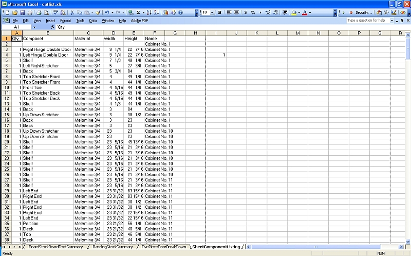

This is a view of the Sheet Components tab before the macro
and after,
You might want to look into Thermwood's Code Splitter software if you want to output eCabinets to your panel saw.
