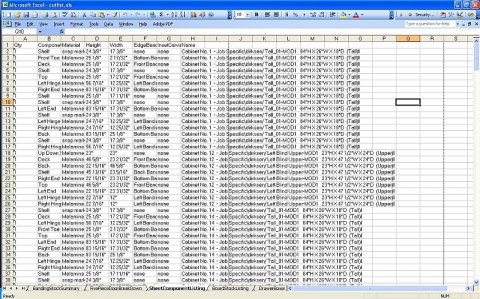

This is a view of the Sheet Components tab before the macro

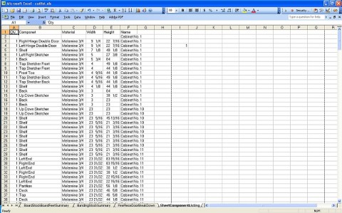

and after,
